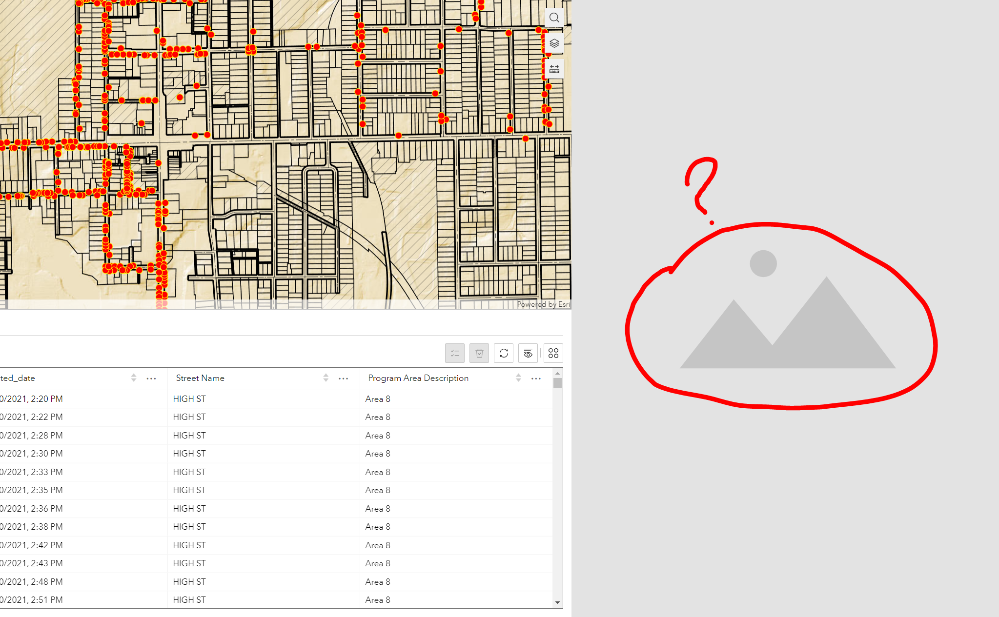

Experimenting with EB on Enterprise 10.9.1. Configured an image widget to display attachments when a feature is selected in the map or table. When nothing is selected (like on initial loading), is there a way to customize it so that gray mountain thing isn't shown? I'd like to have a "photos will display here" message either by configuring the widget or adding a text widget behind it that "disappears" when a record with attachments is selected.

Hi @Mark_Johnson
Similar with https://community.esri.com/t5/arcgis-experience-builder-questions/text-dynamic-content-selected-how-...
It is possible to set the 'empty selection' in the data source panel, so it will show a placeholder image from a certain field. However, currently, we do not have the option to add customized warning text.
We will evaluate this as a potential enhancement. In the meantime, feel free to post it in the Ideas channel.

Mark_Johnson
Thanks for the reply, I was able to find the "View for empty selection" option. I don't understand how it works, but as a test I set it to a random record in my data and that record's attachment displays when nothing's selected. So adding a "dummy" record to the data with a "photos display here" attachment could be a workaround, although purposely introducing bad data is not something I'm going to do at this point just to make an app work.
