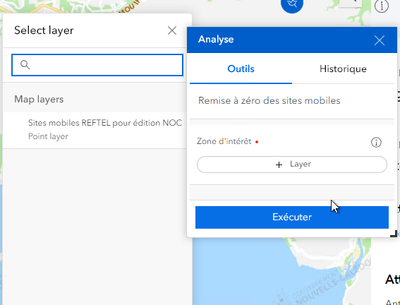

Hi,
I have a similar issue, where my gpserver should allow me to draw on the map, but only allows me to select the point layer that is on my map...
The same is working in my tollbox and in webappbuilder :
WAB :
EXB :
Param :

Wei_Ying
Hi @PierreloupDucroix ,
Drawing features has not yet been supported in ExB analysis widget. We are working on that. Please stay tuned.
