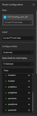

I solved my own problem! In ExB, within the table settings Sheet Configuration pane, you can configure the following settings:
Configure Fields: Customize
Select Fields for Initial Display: Select the dropdown. Here is where you can turn on and off fields visible in the table widget, and therefore the export option.
Then in the filed list below the dropdown, you can customize the order and the default visibility of the fields you kept showing.
