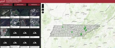

  1. Use the list Widget. You will need to upload a table of unique values (I'm not sure of a different way to do this). In my case, my table has 3 vales: Assessment, Redeveloped, and Remediated. These values need to match whatever column you want to filter. You can configure the widget to look like buttons and match your experience

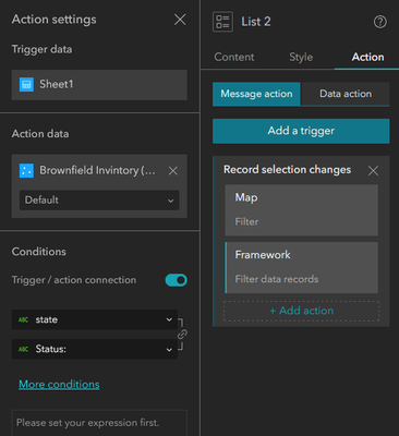

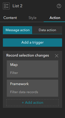

  2. Use the Actions tab to "filter" the map
    NOTE: I called my table "state" rather than "status" because I was rushing to try different things. But "State" is my uploaded table.

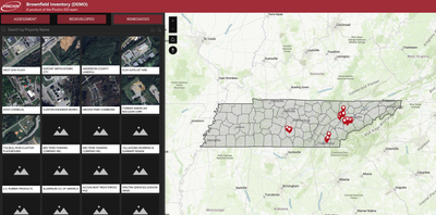

I actually really like this one. It will be a public website later this week as I am setting it up specifically for demo purposes. Unfortunately, you will need to wait a day or so for me to finish a few things. Here are screen caps though...

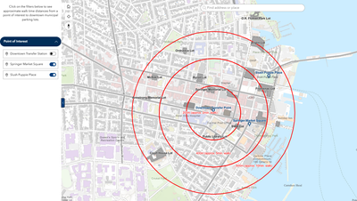

Hi, new to the list widget here. When you bring the list widget in do you point it to the dataset (polygon in my case) or the table? I'm struggling to understand how to configure this. I'm using a filter widget in my app currently. The filters turn on and off/zoom to  layers in a group but the data overlaps since the user can turn on all points of interest at the same time. I'd like to limit them to only be able to select once at a time.
