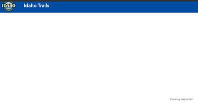

I have a web application created using Experience Builder. All of a sudden, a user is experiencing a "Creating Map Failed" message when try to access the web application. The user has been using this application for the past couple months with no issue. We have tried clearing the browsing data/cache with no luck. A screenshot of the browser error can be found below.
I (the creator of the experience builder) can access this web application with no issues and it doesn't seem to affect any other users.
Thanks,
Josh

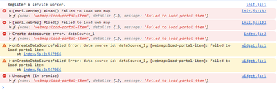

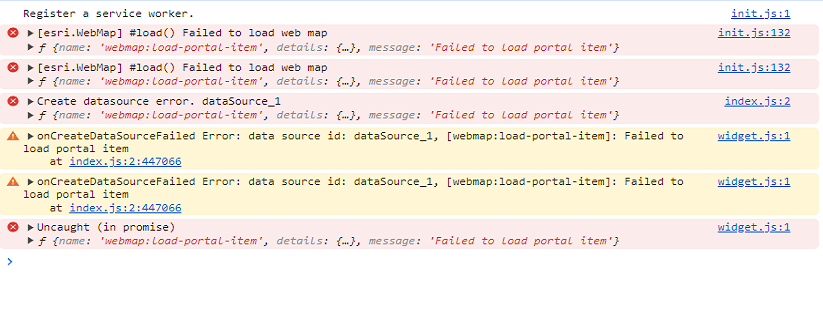

Having same issue with a random user, in Chrome only (but functions okay in Edge on same PC). App is public.
What would be the approach to diagnosing this on a single PC when the issue is with Chrome only?
App https://experience.arcgis.com/experience/97a42a2a73c944ba918042faf518c689
App frame renders but the map (widget) will not render, and none of the several various widget buttons and Search dialog will render.
