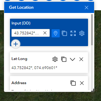

I am trying to create an output format in the Coordinate Conversion widget so the coordinates appear in latitude, longitude format w/o reference to S/N or E/W, and the value is signed.  For example, a coordinate here in the northeast would preferably appear as:   43.752842, -74.690601.
In the widget I configured a new output format named "Lat-Long" with:  Y°, X°
Yet, the longitude does not appear with a negative sign, as shown below.  I tried "Y, X" as well but no go.  What am I doing wrong?

@JohnSasso2 I followed the steps you mentioned and the minus sign does display for me (please see the attached image). Couple of questions for you. Are you using the online version of ExB? If you're using the developer edition, what version are you working with?
JohnSasso
Interesting.  I am using EB Developer edition, v. 1.7.0
