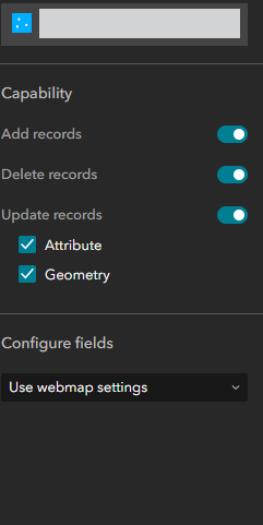

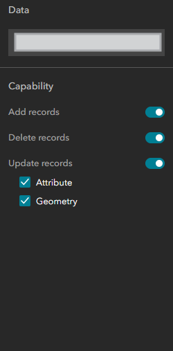

Hello ESRI Community!
I noticed that the ability to configure field appearance in the Edit widget is not available when you have batch attribute editing enabled.
I have a feature layer with many fields that I want to display to my end users in a map pop up and associated attribute table, but only show one field to edit with batch editing enabled so as to update for multiple features at once.
I'm assuming this is by design, but is there any indication on if or when this ability will be added? I included screenshots below of this behavior, one with batch editing disabled and one with batch editing enabled.

Hi @emoreno , the team is looking into the possibility to support customizing fields when using batch editing.
In the meantime, the recommended approach is to create separate editing Forms based on your editing workflows. See this related thread - you can configure different Forms across different maps, or use Feature layer views: > Add batch edit widget to experience builder

Hi Alix,
Thanks for the suggestion, adjusting the form on the layer in my webmap will suffice for this workflow. I do think it would be a good addition and support the idea of adding it in future releases, just for simplicity and continuity of configuring batch and non-batch editing in the widget. I appreciate your help!
