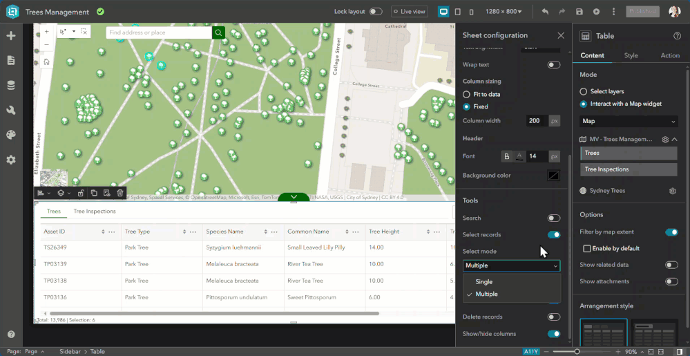

If you're looking to single select features using a tool on the map, you can use the Map widget "Select" tools and the "Shift" key.
Other ways to select features one at the time could be using the List or the Table widgets.

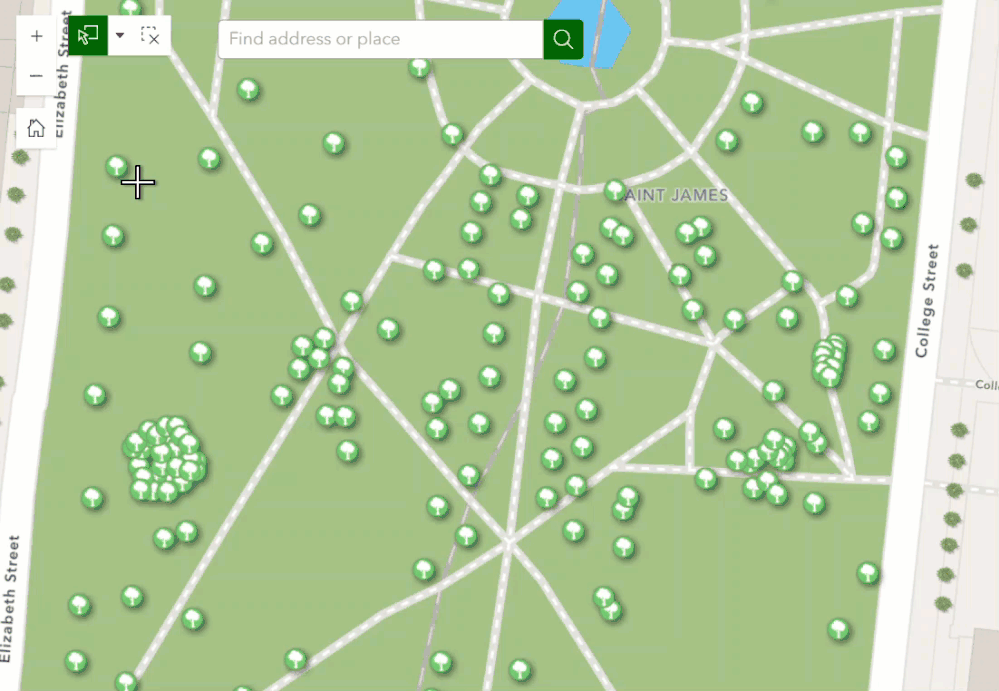

@JuanTomásMartinez17 Looking more into this, I learned that you can add more features to the batch selection, but you need to select at least 2 features to get started. If you select only one feature to start, it loads the form for that feature and then you cannot add to the selection. So, the workflow would be: select 2 features, then press CTRL and keep selecting.

The workflow would be: use the Select widget to select features, then open the Edit widget to edit those features.  Edit widget works on selections.
