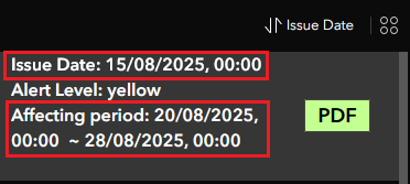

I have made a map app with list widget by experience builder. The list widget can show the data of a standalone table but the date but the date format is DD/MM/YYYY HH:mm but user wants the format DD/MM/YYYY, no time part. How can I do so?

Thanks for your help, but the data are stored in a standalone table of a map service. Besides , the map service is opened in a scene viewer instead of map viewer.
