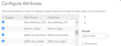

Hi Don - you can also hide the time part of the date field by configuring the pop-up to only show dates. In the Configure pop-ups panel on the layer menu, there's an option to configure attributes. There, you can change the field formatting for dates (and numbers). If you select your date field, you have the option to enable / disable 'Show time' for that particular field. Here's what you should see:

Awesome Chris, what I was looking for.

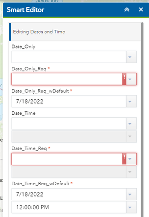

Hi @SineKelly17 , if the Time is disabled for a Date field in the pop-up configuration, the Time dropdown should not be shown in the Smart Editor's attribute form. If it is still displayed, it would be a bug.
I've done some testing on my end and I am not seeing issues with the Date/Time editing. Everything seems to reflect my field properties and the pop-up configuration settings I've assigned. Here's an example in ArcGIS Online Web AppBuilder:
Is there anything specific about your field?
Are you in ArcGIS Online or using an older version of Web AppBuilder (ArcGIS Enterprise Portal / Developer Edition)?

AlixVezina
I went ahead and tried hiding the Time for my Date fields too, and it seems to be hidden as expected...
Yes, at this point I think working with Technical Support would be most helpful so they can help find a potential workaround and reproduce the issue. Thank you for bringing up this issue @SineKelly17 !
