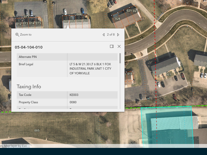

Just updated EB to version 1.8, applied the patch. I'm seeing strange behavior with clicking.
Note the little callout arrow showing where I clicked, and the highlighted feature way off to the southeast. I clicked the map at this scale, too, so the highlighted feature was nowhere near my cursor.

Hi @jcarlson I noticed this as well in the current online version yesterday.  It seems to be occurring with large datasets > 2k records.  I'm using a List>FeatureInfo>Map workflow and after a certain number of records have been scrolled (scroll event on the jimu related?) the list and feature info become out of sync, and display different selections.
This is occurring within a zoning dataset.  In addition, on a click event in the map, the map popup and feature info would display different records.

I was able to overcome this somewhat by using a sorted view (on object id) for the feature info widget.  for the moment the list, map and feature info remain in sync - i.e when i click the map, i get the same record in both the list and info window.

For my viewer, it's not even about the interaction between widgets, it's just "click Feature A, get popup for Feature D, 200 pixels away".

The last time anything like this happing with me was in a beta version of the map viewer in Enterprise, I think 10.8x. It seemed to have an transformation issue with the projection engine, where all my state plane layers shifted.  Probably not the same issue.

Hm. You may be onto something, though, since everything I use is in State Plane. Regardless, none of our users has reported similar issues, so it could just be me.

yeah the only other thing is that, in the online Eb anyway, configuration is often super-laggy, sometimes to the point where I can barely work.  I have had that then translate over to the map in play-mode where I select an item from a list or a record from the feature info and the map will just sit there.  Usually happens later in the day, and probably(maybe?) related to either our traffic or aws . . .
