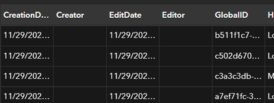

  3. Checked that 'GlobalID' field is appearing within Experience Builder - it is

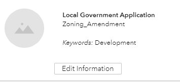

3. Add a Button to the List Widget to link to your second / Survey123 view. Style the rest of the List Widget as you like - I used this as a way for users to check the data of the point they selected before editing, and labeled the Button as "Edit Information". (I no longer have access to the app I built for this post, but this is the idea:)
4. When the user clicks the button, it should take them to a loaded Survey123 view, since clicking the item on the List selects the associated record across the framework.
