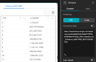

3. From Embed widget setting, you will see exampleParam in URL info. It can be added to the embedded URL by clicking on it. You can replace any content with {appURL.search.exampleParam}. Let's say we replace value "20" - now the filter changes to

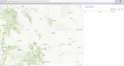

 4. Now save the app, publish and view the app. The app launches with no data in it (as the SQL expression in the Embed widget is incomplete and invalid)
