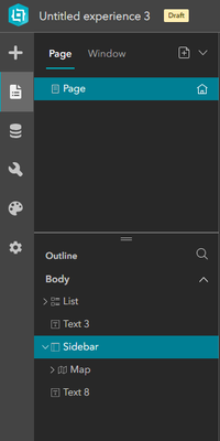

First find the Sidebar Widget. The easiest way is to look on the Page Tab.

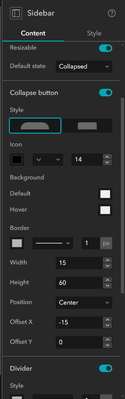

Then adjust the Collapse Button settings. You may need to unlock the layout, if you haven't already.
