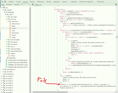

Thanks for raising the issue. I tested creating a data source based on a public feature layer item but couldn’t reproduce the error. Could you share a data source JSON that can reproduce it? Did you log in when reproducing the issue? It would be even better if you could click this line to show why it’s trying to read 'token'.

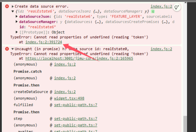

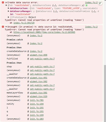

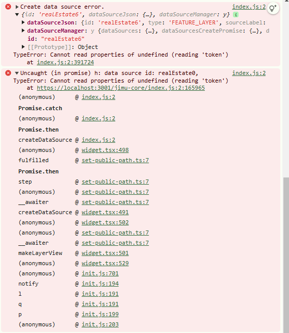

The error stack from the Promise result reads: Error: data source id: realEstate0, TypeError: Cannot read properties of undefined (reading 'token')
at ...filePath/cdn/17/jimu-core/index.js:2:165965
Yes, I should be logged in. And layers that require some sort of authentication load without issue.
