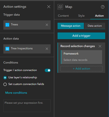

You could setup a message action to select related records/features when selecting a parent feature, and those selected related records would be loaded into the Edit widget for batch editing.
Message action example:
But since batch editing is not supported for the Attribute only mode in the Edit widget at this time, this way only work for related "features", not table records.
