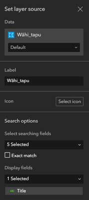

Hello there,
I'm using the Search widget for two feature layers in an Experience Builder application. As shown below, I'm searching within 5 fields for this particular feature layer. I can get search results without pressing Enter for some of the fields but for others I get "No search results" and have to press Enter to see the results. Why might this be the case? There are differences between them (e.g. max length, whether null values are allowed) but I can't imagine it's related to these differences.
COwen_0-1713924014463.pngCOwen_0-1713924014463.png  COwen_1-1713925282654.pngCOwen_1-1713925282654.png
Also, for all of the 5 fields, I get "No search results" for text that is not at the beginning of the string and have to press Enter to see the results. Is there a way to resolve this, even if this means removing all search results before pressing Enter?
Many thanks

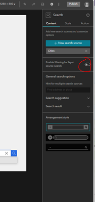

AlexHogan
Hi @RebeccaWatson1
I think if you enable the setting 'Enable filtering for layer source search' this issue should not occur
