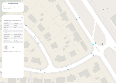

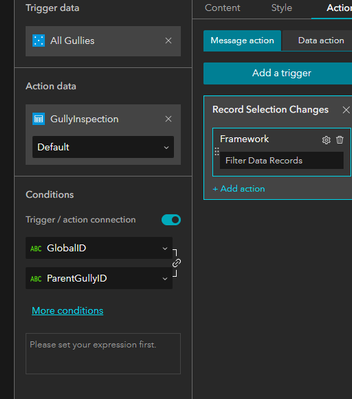

JonathanMcDougall
@Kara_Shindle
This ExpB is one I've embedded into a Roads Service ExpB allowing the user to see the inspection history of a gully, as you can see the map selection gives the right data in the Feature Info widget.
The way to do this is to preserve the relationship between GlobalID and the ParentID (GUID) from the map action selection.
Is this what you're after?
