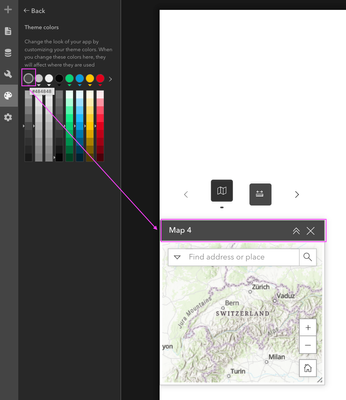

You (or the template you are using) have placed your Legend Widget within a Widget Controller. The heading color for a widget in a Widget Controller is the primary color from your chosen Theme and can only be changed by choosing a new primary color, but be aware that this will alter colors all over your application. Here is my guide for making a Theme.
If you take the Legend Widget out of the Widget Controller, it will not have a header bar by default, but it will also be permanently open.
Your best option may be to alter your header row color to match the Theme you chose.

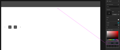

The styles of widgets within the Widget Controller are managed by the Widget Controller itself. This ensures a unified behavior, where style settings do not apply to each individual widget.
For maintaining consistency, if you wish to include the Legend in the Widget Controller and align its header with the controller popup panel header, I recommend keeping the primary color consistent with your header color, as advised by @JeffreyThompson2 .
