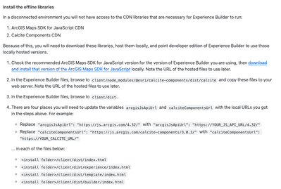

In offline environment how to set calcite module for the Exb dev version(v1.17)?
There  is no introcution on this topic in the official document.
8 Replies
JunshanLiu
We'll update the doc in the coming release.

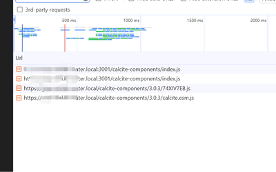

       Follow the steps above, got the problem as below.

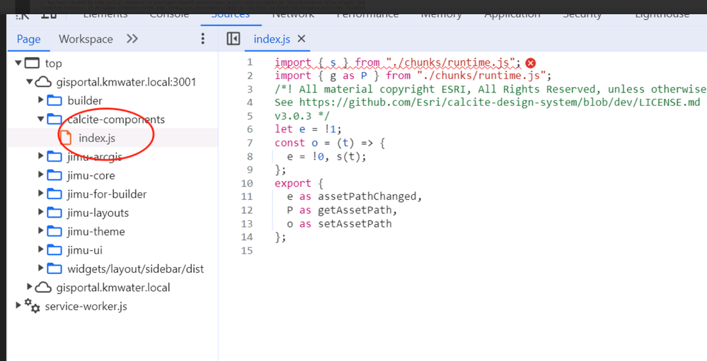

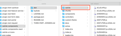

Have you copied this folder to your web server? It seems there is no index.js (in your snapshot) file in the folder.
baohuachu7
yes, copied. There is no index.js file in this folder.
JunshanLiu
@baohuachu7 I guess you may use the wrong URL for the "calciteComponentsUrl".
There is a "calcite-components" folder in the "dist" folder, but the "calciteComponentsUrl" should point to the URL you deployed, which does not have the "index.js", but it should have the "calcite.esm.js"
baohuachu7
Hi @JunshanLiu  I think  the "calciteComponentsUrl" is right.  "calcite.esm.js" is linked.

Junshan_Liu
The server that hosts the Maps SDK or Calcite needs to support CORS, see https://developers.arcgis.com/experience-builder/guide/install-guide/#offline-install
