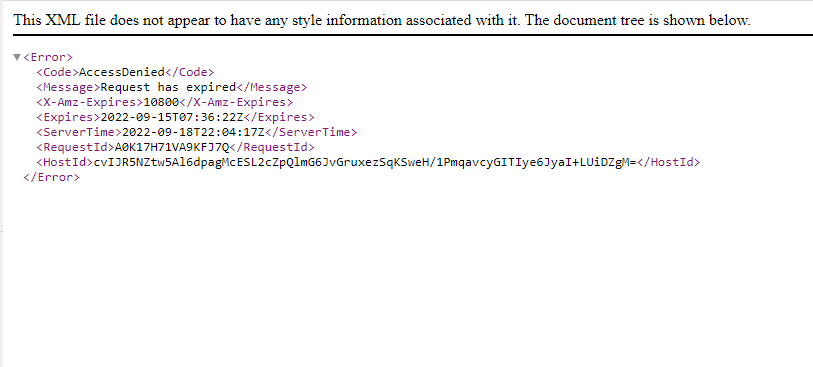

I have uploaded some PDF documents up into ArcGIS Online. I have buttons in my Experience Builder that take you directly to them. They were working the first couple of times I tried. Now I'm getting XML error messages. Other users have reported this too.
Has anyone else experienced this before or am I doing this incorrectly?

This looks like you have a permissions issue. I suggest setting the AGOL item's Share to Everyone (public).
Another common issue I've seen is copying the URL from the the Open link, which includes a token regardless of sharing permissions. Copy the URL from the bottom-right column of the AGOL item page instead.
Good luck!
Lindsay
@DougLogsdon2 Thanks for your reply. Yeah, currently don't have it at public sharing level. That's a good point! With files you can't copy the URL from the bottom-right corner I don't think. That option didn't show up for me. That works really well for me when working with feature services though. Thanks again!
