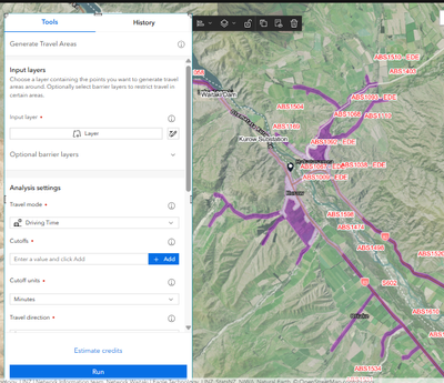

@Robin - Is using the Analysis Widget an acceptable solution? You can use the Generate Travel Areas tool.
Sketch an input location and run the tool.
The downside is that it stores a layer for the output.
You could possibly use this in conjunction with the Print Widget.
