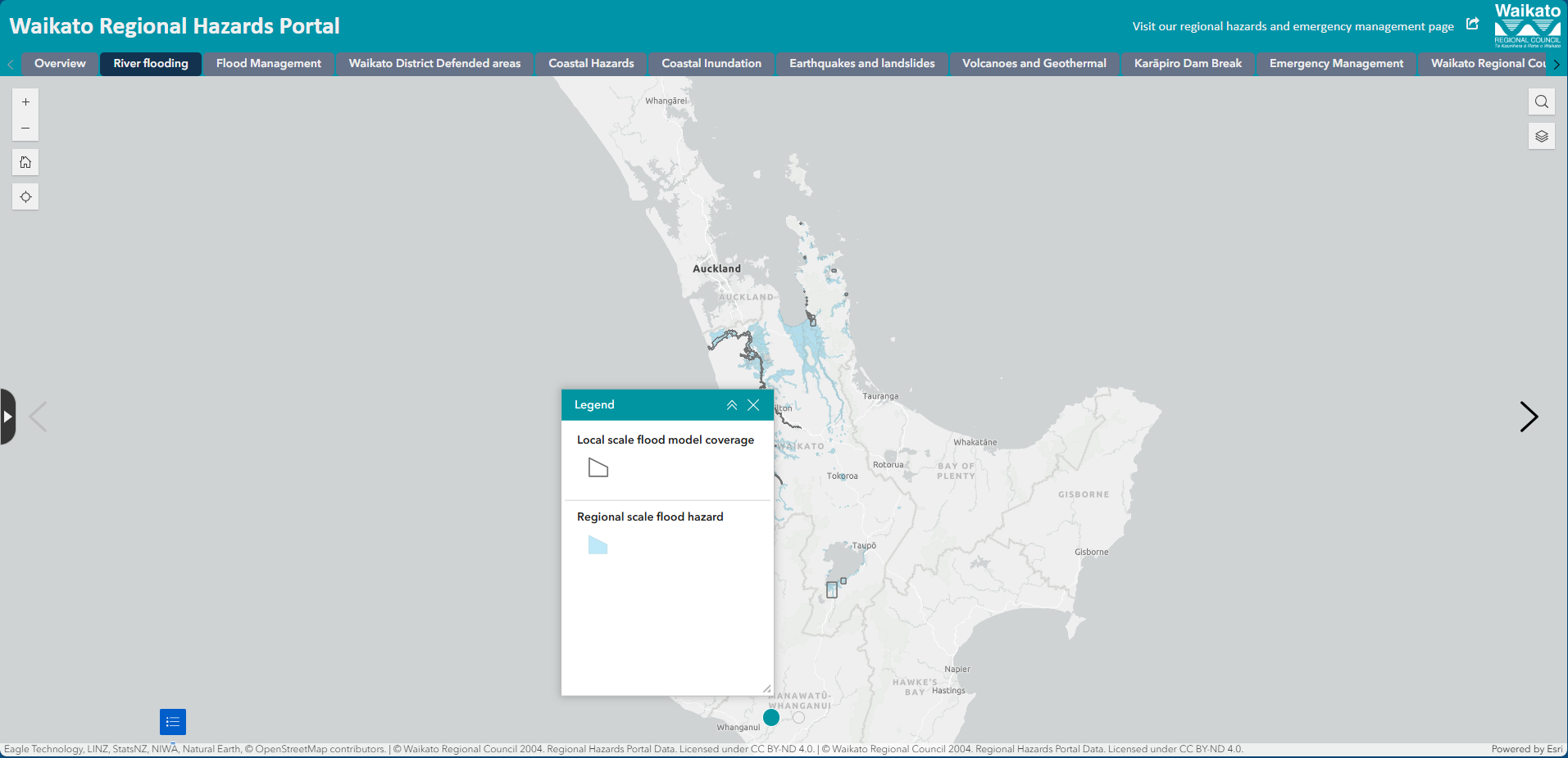

View when opeing the experience with legend panel open by default:

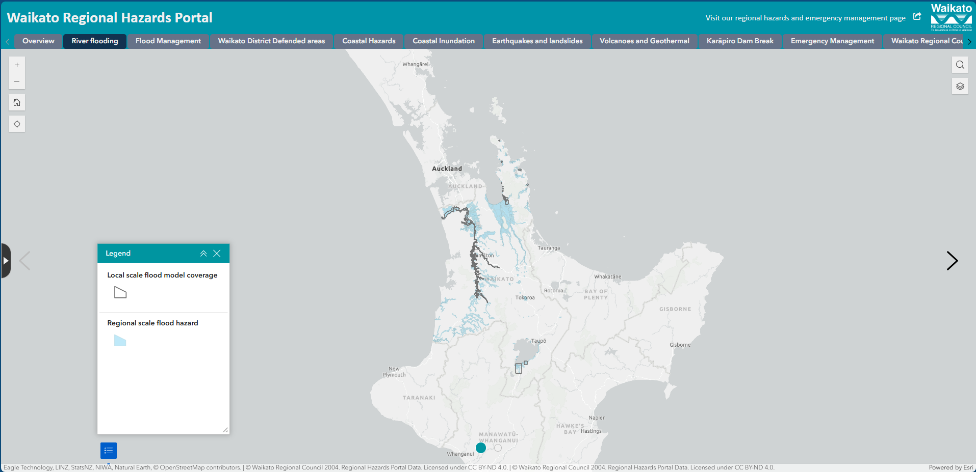

If I collapse the side panel, the widget always moves, but sometimes the legend panel does not:

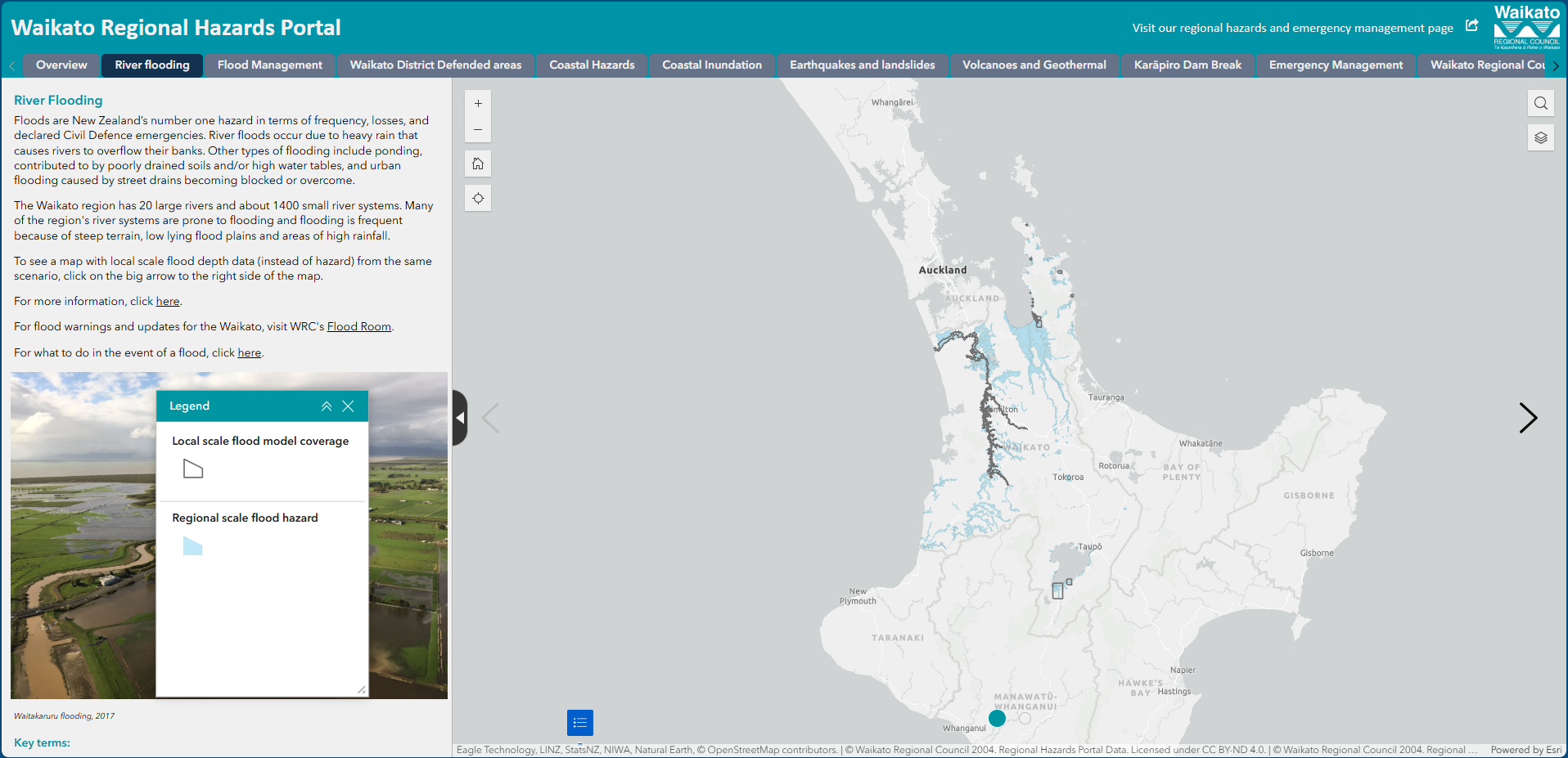

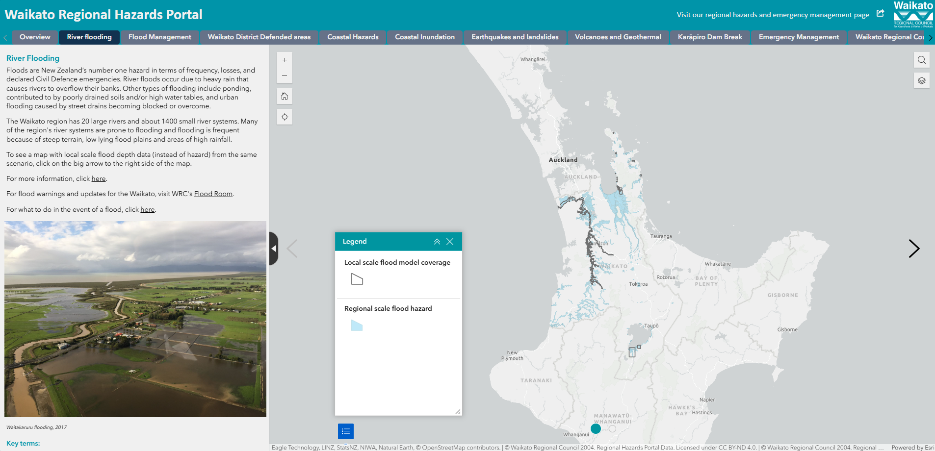

If the legend panel does move when I collapse the side panel sometimes it does not when I expand the side panel again:

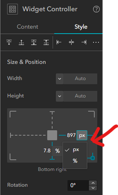

When you use a Widget Controller with the Floating Panel option, the Panel is placed relative to the location of the Widget Controller. Your Sidebar causes the map area to resize and the Widget Controller to move, but the Panel doesn't get the message and stays put. Probably the best way to fix this is to use the Widget Controller Style Tab to set the location based on the right side of the screen. This should keep the Widget Controller and Panel from moving when the Sidebar opens and closes. You may need to use px instead of %.
You may also want to use the Overlay option in the Sidebar Content Tab. This will prevent the map area from resizing when the Sidebar opens or closes.

The inconsistent panel location you’re seeing is likely due to a subtle behavior in our logic: the floating panel remembers its position once users move it. If you open the widget panel without moving it, the panel will always follow the icon. However, once you move it (even clicking the header counts), that position is remembered and used going forward.
At the moment, I don't think there is a workaround for this behavior unless the controller is enhanced to offer more options. As a practical solution, I’d recommend placing the controller at the bottom right of the map to prevent the panels from overlapping with the sidebar.
