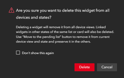

Additionally, was the message below always present? If not, are these stale widgets legacy items from before the message was added, resulting from some sequence of removing widgets from one device and not another, or switching from custom to auto, causing them not to be properly removed from the code?

For the delete widget warning window, it is not always present. It'll be displayed when we delete a widget that are referenced by multiple devices.
