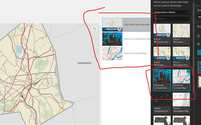

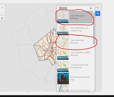

I'm not sure I understand what you're saying so I've replicated my workaround in an example Experience Builder project. In the screenshot below I've added a web map to an Experience Builder project. The web map uses a custom basemap called "City of Worcester Basemap". If I turn on the Basemap option in the Map widget, I get the duplicated basemap options - one with the thumbnail and the one with no thumbnail which I have circled. There are some other custom basemaps in the list which can be ignored.
I think it is confusing to the user to have 2 instances of the same basemap like this. So my workaround is to use the standalone basemap widget. If I choose our organization default basemap group, I can keep the "City of Worcester Basemap" unchecked. As shown in this screen shot, the only basemaps I have selected from the basemap group are the 2 enhanced contrast ones. When I do that I have 3 basemaps included in the basemap picker - the 2 enhanced constrast basemaps and the basemap used in my web map which makes a lot more sense than having 2 instances of the web map basemap included in the picker.
