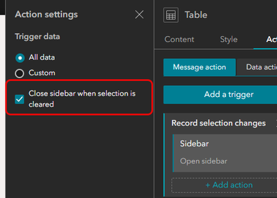

Hi @MarkusLandauer @anonymous55 ,
This feature is now available in the latest version of ArcGIS Online.
Regards,
Shengdi
