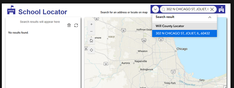

I've been trying unsuccessfully with the Javascript SDK in numerous ways using the search widget on a feature layer. I've tried the Instant Apps Zone Lookup template; the official replacement. But, I moved on because when I clear search location it only clears the selected points, not the related polygon. Also, the layout leaves a lot to be desired.
Working in ExB, the layout/design is whatever you want it to be, but getting the widgets to play nice is another thing. What I have so far is really close to my end goal. I need help with these couple things:

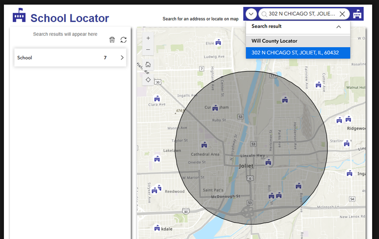

  • I'm using a webmap with point and polygon features that have a related join. In ExB, the Near Me widget Analysis is set to Proximity with a search distance of 1.5 miles.

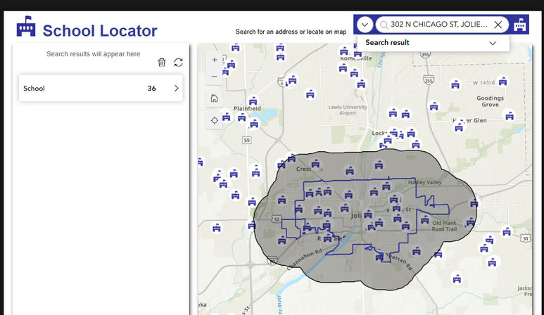

    1.  If you search 302 N. Chicago St., Joliet, for example, it functions the way I expect. I have School set as the Search source and as the selected layer in the Near Me widget. But, what's unexpected is when I click the map (on Joliet, for ex.) the distance of 1.5 miles is added to the polygon too. Why?
    2. Use map pin and label as on the Zone Lookup Instant App (while at the same time keeping the Map-->Near Me record selection changes).

The polygon layer is the Selected Feature and you have your analysis set up to search 1.5 miles from the Selected feature. When using the Search Widget, the place the search starts from is a point.

What are the polygons on your map? Are they school catchment areas? If so, you could change your search distance to 0 and get the mouse clicks working. Then have your Search Widget trigger a hidden Near Me Widget that finds polygons and triggers the school search as in the linked example.

It's a vicious circle. I set the proximity to 1.5 miles in Near Me to get the surrounding schools with an address search, but then the click in the map shows the proximity on the polygon too (which I don't want).

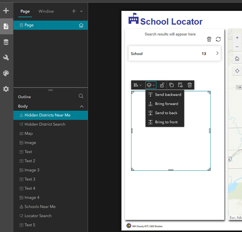

Are you using two Near Me Widgets? In my build, the Search Widget triggers a hidden Near Me Widget that is responsible for finding what polygon the search result is within. This Near Me Widget then tiggers a second Near Me Widget that is responsible for finding the points within the polygon. Clicking the map directly triggers the second Near Me Widget and not the hidden one.

No, I wasn't using two widgets when I wrote that. I went over your blog a few more times and it finally does what you'd expect! To hide the additional Search and Near Me widgets I sent them to the back behind the other widgets.
