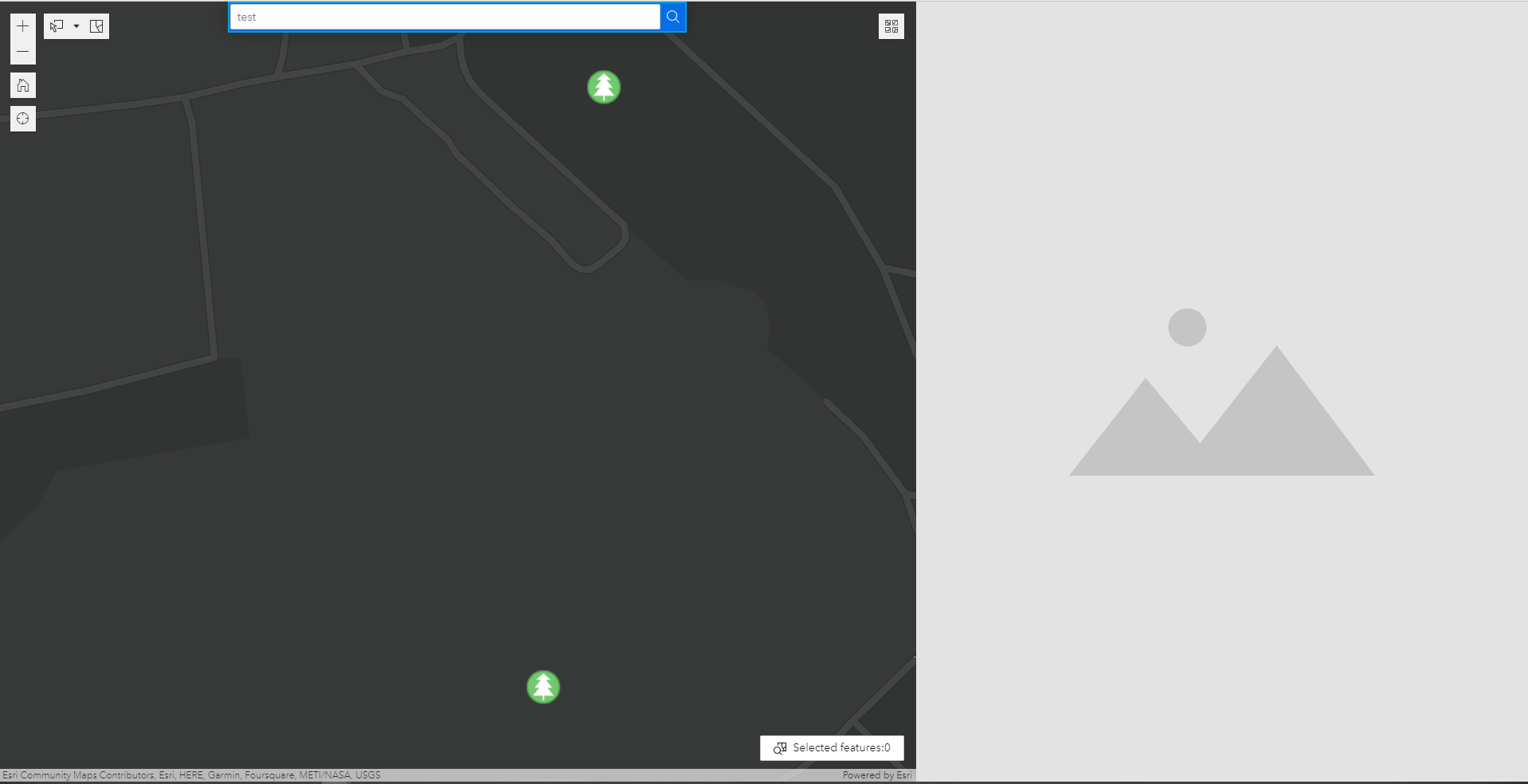

here you see the initial stage

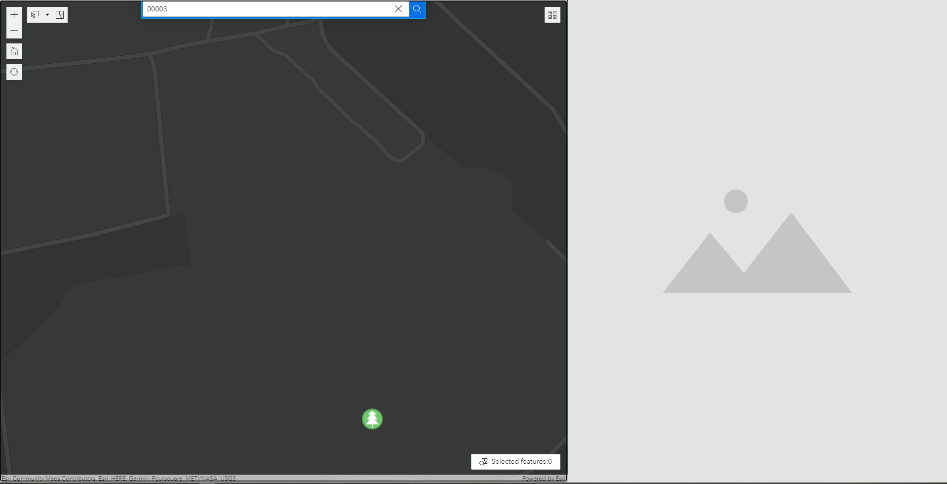

here I search by ID: 00003 and the record in the map is selected. the image widget containing the attachment is empty.

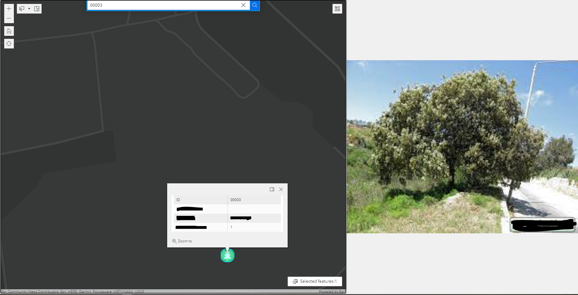

If I select the point in the map, the image appears, but I would like to have the selection without having to select the point in the map.

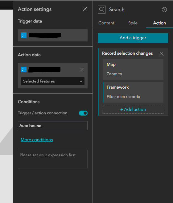

This is one of the settings I tried for the action of the search.
I am not able to see what is wrong, but the trigger has always been tricky to me... 😣

@PanGIS - The reason being -
The dynamic image > Attachment supports "Selected features". Thus, it will only receive valid data once a selection is made;
When doing a search, it is either to filter the data source (layer search) or generate an output ds (locator search), none of which makes a selection automatically. That's why you will only see the attachment once you manually make the selection.
