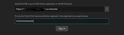

This is the error when I put in the App ID
CW-GIS
I tried it again, this time it's just goes to a blank screen, no error message
