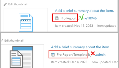

Another possibility I can think of is that we currently only support .rptx report files in Experience Builder.
This type of item will show up as a Pro Report in the item details:
