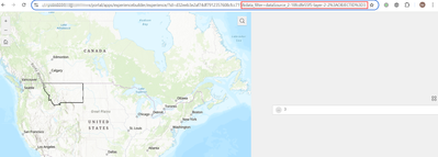

Hi KevincFox_bia,
In the URL, there can be only one question mark , the splice statement uses the &
Take filtering OID =3 as an example.
https://yourportalsite/portal/apps/experiencebuilder/experience/?id=d32eeb3e2af74df7912357608cfcc715&data_filter=dataSource_2-18fcdfe55f5-layer-2-2%3AOBJECTID%3D3
It does work on Portal11.2. Please try at your side.
