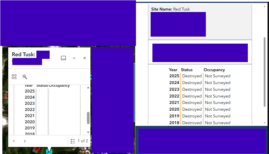

On the left-hand side is the pop-up in the Map Widget. On the right-hand side is the Feature Info widget, showing the pop-up as expected. All of the missing data/styling on the map widget pop-up was generated by functions within Arcade (in the pop-up in MapViewer), which is why I suspect them to be the culprit.

I can't imagine why this would be the case based solely on your provided code, but I notice that you do have at least one variable (bgcolor) you haven't shown so I suppose I'll ask: Are you sure they're not showing up? Might they be white text on white background somehow? There's a setting in the feature info widget that can override some popup arcade, so perhaps it's doing that which is why it looks black in the feature info widget?

There is no text at all, I did double-check whether it had turned white. To that end, there is other text in the pop-up (not generated by functions) which appears as expected in the Map Widget pop-up and is black. I have my 'Theme' text in ExperienceBuilder set to black.
Bgcolor changes the colour to the left of the Status and Occupancy value - you'll notice that it's all grey in the left-hand pop-up (Map Widget), while yellow is appearing properly in the right-hand pop-up (Feature Info Widget), which indicates that that function isn't working either in the Map Widget pop-up.
