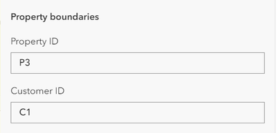

This works as expected when I add a new feature from the Web Map:

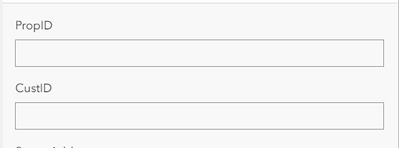

But nothing happens when using the Experience Builder Edit widget

Hi @FranklinAlexander , this is a known limitation right now.
The Forms you configured will not come through in the Experience Builder Edit widget when you use Attributes only mode, but it should work as expected if you use Geometry & Attributes when configuring the Edit widget.
