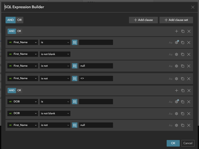

NicoleDaniels802
Thanks so much, Cody! For simplicity, I tried this with 2/3 fields; however, it's still not forcing the AND.
Here is the updated SQL Statement:  ((First Name = ?) and (First Name ≠ 'NULL') and (First Name ≠ '<>')) and (Date of Birth = ?) and (Date of Birth ≠ 'NULL')
I’m assuming that ‘NULL’ is being treated as a string (which we don’t want) – but I can’t find a way to filter for “is not null” otherwise. I tried “is not blank” and it also does not accomplish what I need it to.

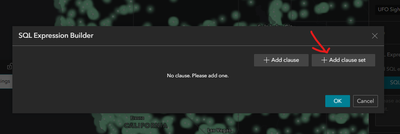

When you created the Filter, did you use Add Clause or Add Clause Set? I think Add Clause Set should work for you.
GIS Developer
City of Arlington, Texas
NicoleDaniels802
I've tried both and no success with either. Clause Set:
