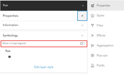

You can disable the "Show in Map Legend" option for a layer in the Map Viewer. This will prevent the layer from being included in the map legend and printed legend, while still keeping it as one of the visible layers on the map.
Regards,
Shengdi
Regards,
Shengdi
JonathanLee
This worked perfectly! Thank you @ShengdiZhang!
