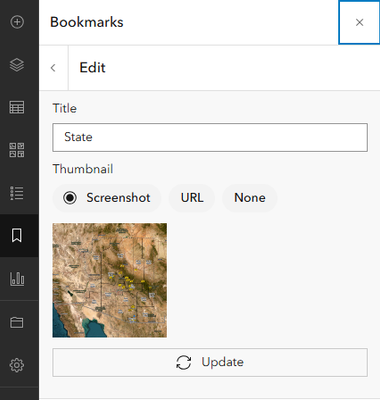

lklun
You can do it directly in the web map. Go to your bookmarks and click the edit icon next to it, then you can use a map screenshot or add a thumbnail via URL

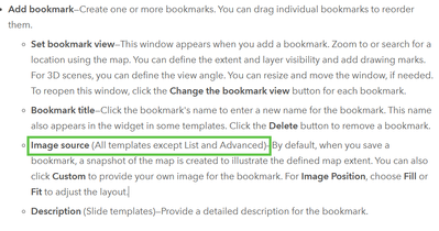

Hi @ZélieSchuhmacher,
Please refer to the doc here.
Thanks,
Ke
