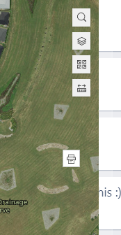

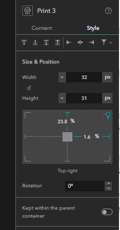

Hi ExB community,
I want to add the printing widget and have it lined up with the default map widgets.
I'm having issues getting it to match size/position. I have tried px and %. The ExB will be used on large and small screens.

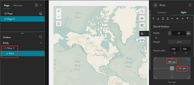

Hi @Lindsay ,
To align the print widget with the map tools, you'd better place the print widget inside the map widget and use px to set the print widget position:
This allows the printing widget to be aligned at all resolutions that use large screens, but for small screens, you need to customize the layout.

Thanks @ShengdiZhang! That worked 🙂

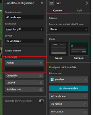

@ShengdiZhang While we're on the print widget, are there ways to use dynamic text for layout option set defaults like author?
ShengdiZhang
Sorry, you cannot do this in the print widget.  The Print widget does not support connecting to data, and we have no plans to do so at this time, so it is not possible to set default values using dynamic text.
