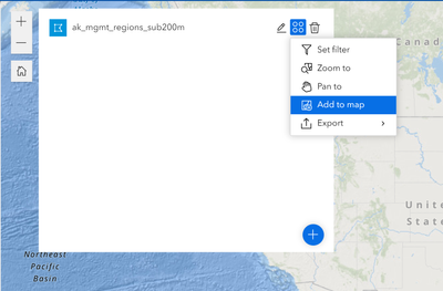

Did you also click the Action button and select "Add to map"?

@KenBuja I do not see that option, only "Set Filter" or "Export". Could this because the .kmz is a georeferenced site plan, not vector data?

It seems to have a problem with kml files (kmz files don't seem to be supported). I can add a kml file to the Web AppBuilder Add Data widget and it shows up as expected, but I just get the Set Filter and Export options using the Experience Builder widget
