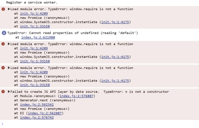

The dev-console error stack is this.
JeffreyThompson2
MVP Frequent Contributor
https://developers.arcgis.com/experience-builder/guide/add-layers-to-a-map/#change-the-widget-name
Based on the error, I am guessing that you did not include jimu-arcgis in your dependencies in manifest.json as shown in the link.

diplonics
Yep, that fixed it, thanks again for your input and help on all bits, its appreciated.

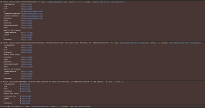

Below is an image of the console errors. When the widget first loads there is no GeoJson data. If the load data button is clicked a layer refresh occurs and is fine as long as features are returned, if none are returned then these errors occur and further updates to the layer fail. Is there a correct way to handle exception cases where a query that returns no features just clears the map and shows a message of 'no data top load'.
JeffreyThompson2
If I understand your problem, you have code that functions and does additional analysis if the API returns data, but errors out if there is no data, and you want to know how to handle a no data senario. Practically, the best option would be to inform the user that there is no data to work with and allow them to start over. There are several ways to accomplish this (if/else, try/catch, or moving part of your code down the React tree), but they are all fundamentally just different ways to make an if statement.
