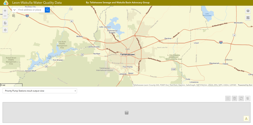

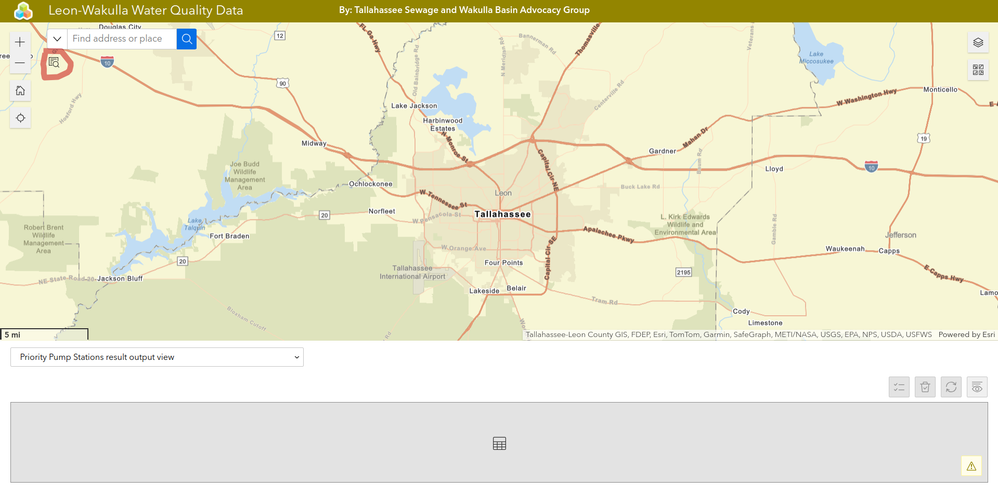

Greetings! Given the following two screenshots, the Query widget icon seems a bit hard to spot, is there a way to customize the icon? (The Query widget icon is circled in red)
Screenshot from 2024-02-23 12-07-07.pngThe Query widget icon is circled in redThe Query widget icon is circled in red

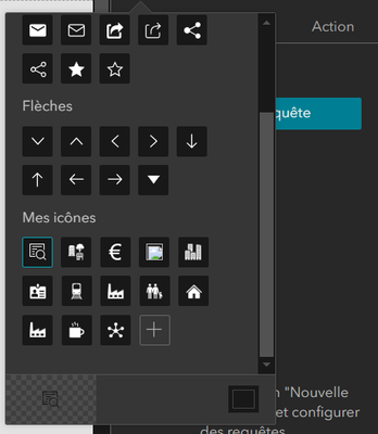

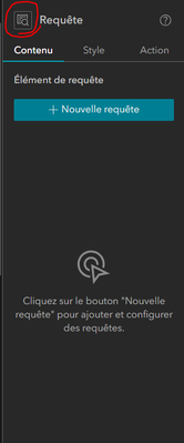

Hi @Shixian_Sheng to customize the icon of a widget it's easy.
Click on the widget on experience builder and click here :
then scroll down here :
and click on the "+" button to add your own icons.
