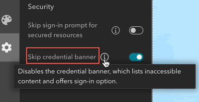

@Jianxia @Wei_Ying Using the Security options count as canceling the login popup and trigger the affects documented by @RyanTaylor.
GIS Developer
City of Arlington, Texas

Thanks for the post. I am using Experience Builder 1.17 and this does not seem to be available to me. I updated my post to reflect the version number.
