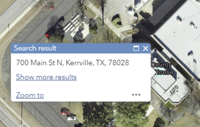

Please add the ability to show a popup on the map when displaying locator search results on the map like ArcGIS Web AppBuilder does. I know you can show a popup when doing a feature layer search, but there is no option to show a popup when doing a locator search.

This feature is implemented in the Nov 2024 release. Please follow the steps below:
1. Select the search widget, check the "Auto select the first result" option under General search options - Search results
2. Switch to the Action panel, add a message action "Records created - Map - Show on map", and check the "Set as operational layers" option
3. Select the map widget, under Options, check the "Show pop-up upon feature selection" option
