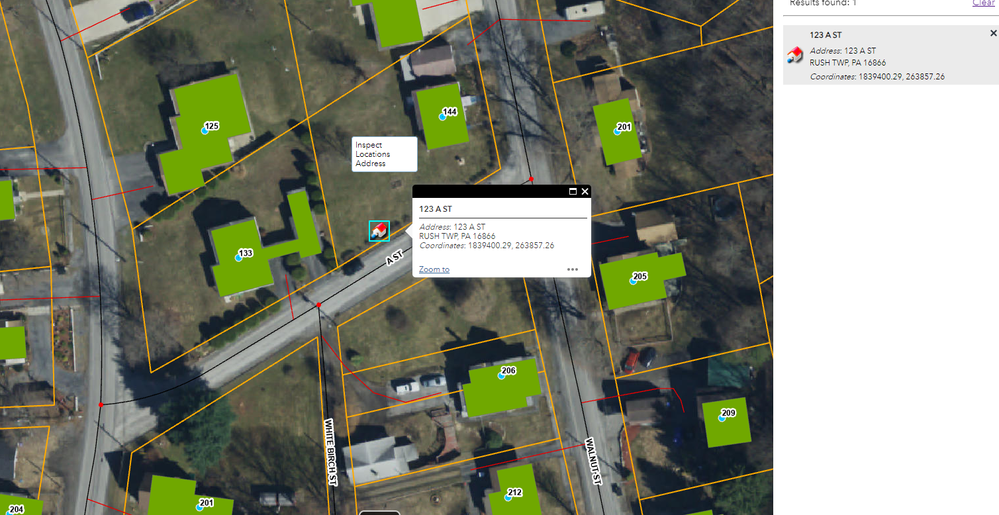

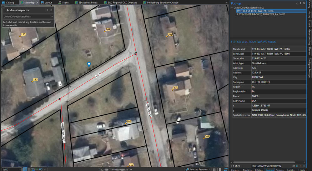

Here is a picture of the reverse geocoder in ArcGIS Pro - Notice the Match Address vs the Address field that is output from the Address Locator.
Here is a picture of what the EXB Reverse Geocoder outputs - Notice on the right side under address it gives the Match Address and not the actual address.
So, my idea or enhancement here is that there needs to be a configuration here to allow this tool to use the address field.  If a configuration is not possible then this tool needs to be changed to read the Address field rather than the Match Address.

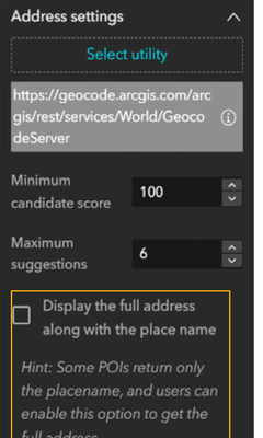

FYI, we've recently added an enhancement to display full address along with the place name. The change is at the config level as highlighted below. Once it's checked, users can see the full address along with the placename in the Address section of the widget.
