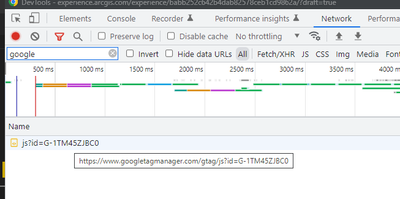

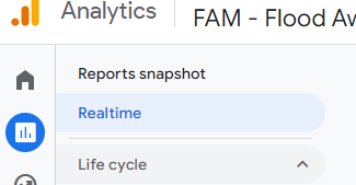

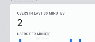

FredericPoliart_EsriAU
I am just testing it now .  I created a new Experience Builder (online, not the dev edition)
and I added the embed tag.     It's actually on https://experience.arcgis.com/experience/
I can see the result in Google Analytics:
and the Google Chrome network analysis does show the ExB app fetching/sending something to GA
