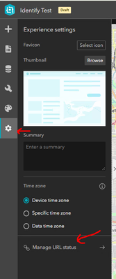

Turn on URL Parameters by hitting the Gear Icon then Manage URL Status.

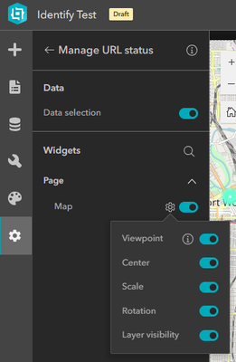

Turn them on for your Map Widget and select what kinds of parameters to use.
Let the Share Widget tell you what parameters are used for the input.

I missed that settings wheel....works like a charm now, thank you!
