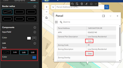

@MelissaBrooks oddly enough in ExB there is a section for links, however the color has no effect. Only the underline settings make a difference. I tried adjusting the theme to no avail.

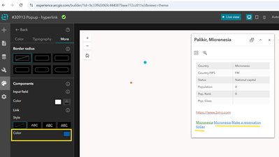

This is fixed on ArcGIS Online in February 2026 and will be available with ArcGIS Enterprise 12.1.

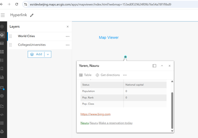

You can change the color of links in pop-ups in theme settings. However, the link style setting in theme settings does not affect links in pop-ups. Links in pop-ups prioritize Map Viewer style settings.
