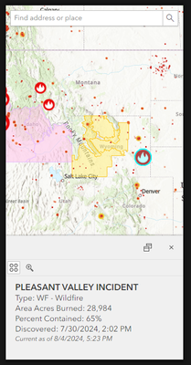

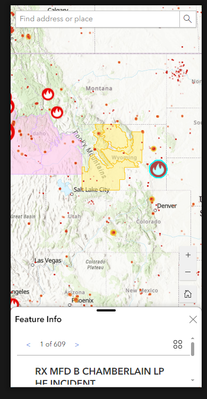

Compare how the default web map popup opens on mobile vs the popup from the Feature Info widget in the Controller:
Feature Info (will always be the same size):
Default web map popup (will vary based on popup content)
