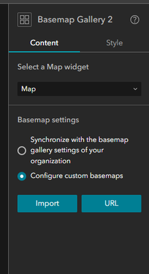

We have a similar situation. One workaround we are thinking of doing is through the basemap gallery widget. In a fairly recent release of EB, you can configure custom basemaps. It is an additional task to set it up, but might work for not having to change the anonymous access settings.
