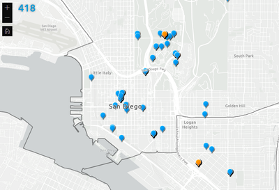

This is possible, if you're referring just to features in the map extent as that extent changes.
Create a card or something, insert a text box and connect it to your data. In the text box add a dynamic COUNT().
On the map, go to Actions, and set an action of extent change on the framework and select your feature layer. This will dynamically change the feature count in the text field.
I quickly chucked an example on a map, here;

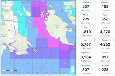

I have a somewhat irregular grid of 445 polygons (called quads in this instance) representing whale sightings. For each quad, there is a total of all whale sightings for each month of the year summed over a period of 24 years as well as the complete total (sum of all months) like this:
Quad   January   February   March ... Total
181                  64            53               83   ...    4964

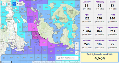

I have one indicator for each month. When one or more quads are selected, the main indicator number sums the values for all selected quadrants for that month. The Reference number sums over all quadrants for that month to show the totals for the month in the entire dataset. Here is a screenshot of what this looks like with quad 181 selected:
When no quad is selected, the main indicator number shows the totals in the map extent for each month.

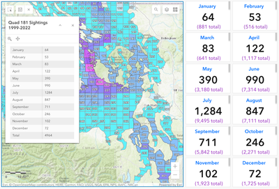

In Experience Builder, I'm able recreate this to some extent with the message trigger on the Framework, but the totals (in the parentheses) change with map extent (as expected).
For now, I'm going to stick with the Dashboard version because this is what the users are used to seeing, at least until I can figure out how to have both the total value regardless of extent and a total that gets filtered by the current map extent. I still haven't figured out the best way to make use of the "View for empty selection" in this context.
