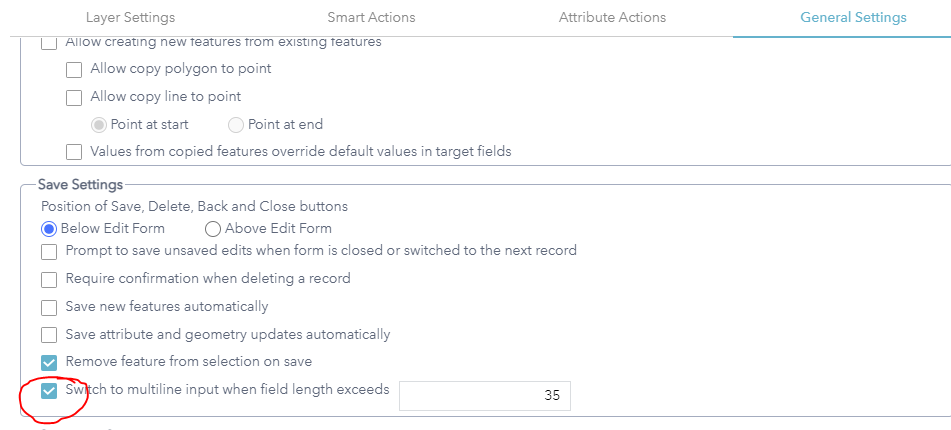

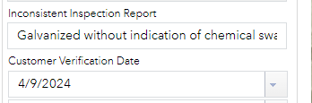

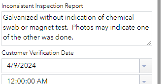

It looks like this can be accomplished in the General Settings of the editor widget under Save Settings "Switch to multiline input when field length exceeds X" turned on.  I know that does not seem very intuitive and to be honest I am not sure what else it is doing but I was just messing with the settings and it seems to have fixed the display.

LJackson29
@HMarcks Can you clarify where you are taking those snapshots. I don't have anything that looks like that in the Experience Builder Edit Widget or Map Viewer Forms.
Thanks!
KevinMayall
That looks like Web App Builder, not Experience Builder.

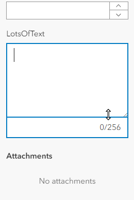

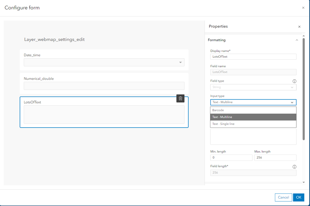

For multiline text input in the Edit widget, you need to configure a Form for the editable layer. You can do this directly within Map Viewer. Configure forms for attribute editing (Map Viewer)—ArcGIS Online Help | Documentation
When you add the text field to the Form, make sure to choose the Text - Multiline input type.
Then, when you edit attributes for the features, you'll see that multiline input and will be able to expand it.
